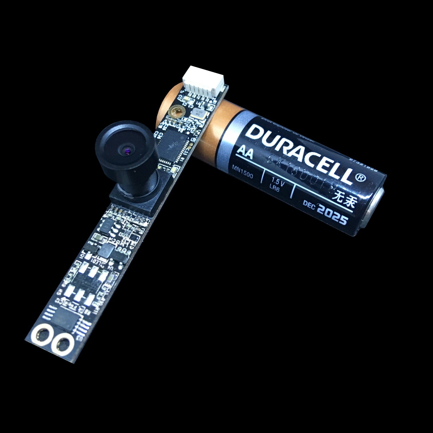

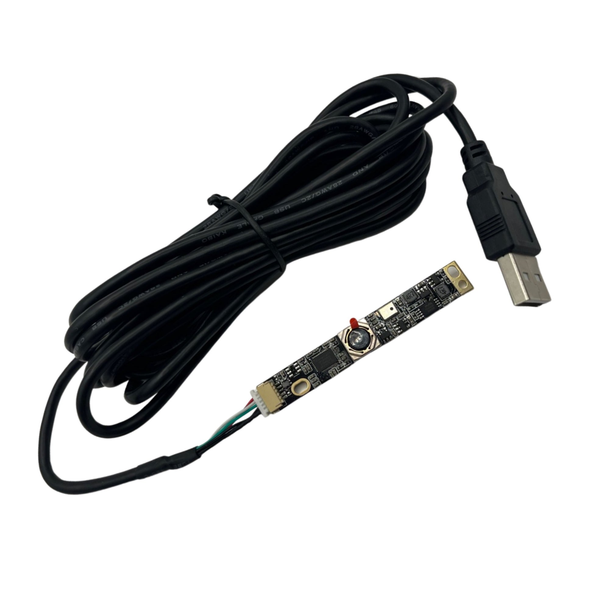

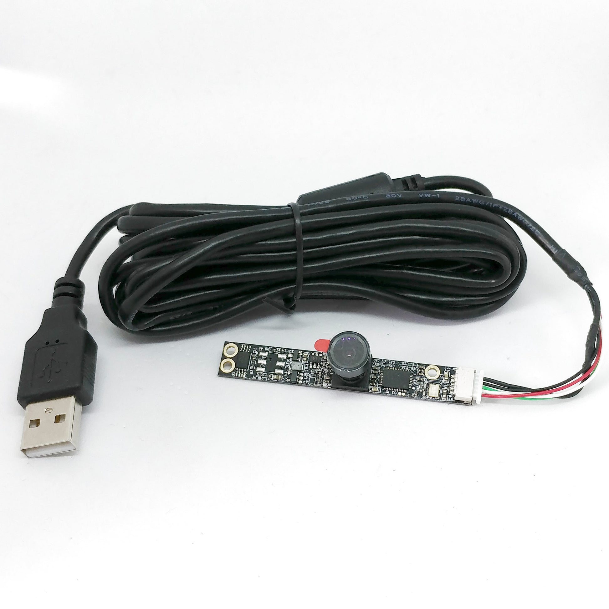

This is a 5 megapixel (2592 x 1944) USB camera, configured by the manufacturer for use with LightBurn, and will work equally well on Windows or Mac systems. The camera uses a CMOS sensor, with automatic exposure and white balance, and a manually focused lens.
Each camera comes with a lens of your choosing, and a 3.2 meter (10 foot) USB cable.
