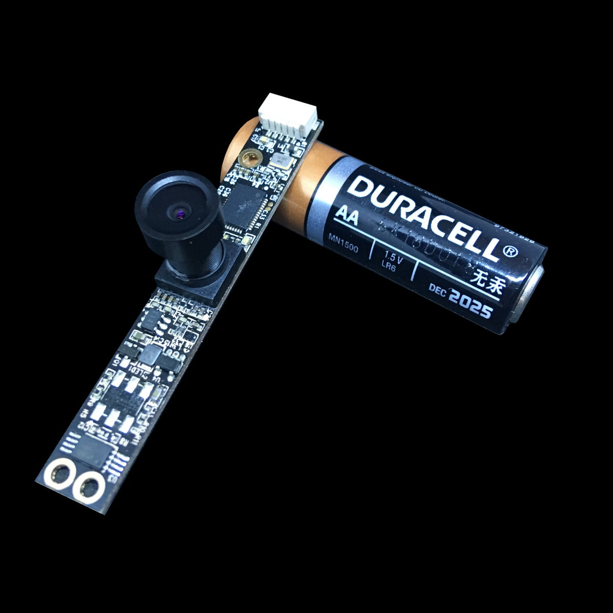

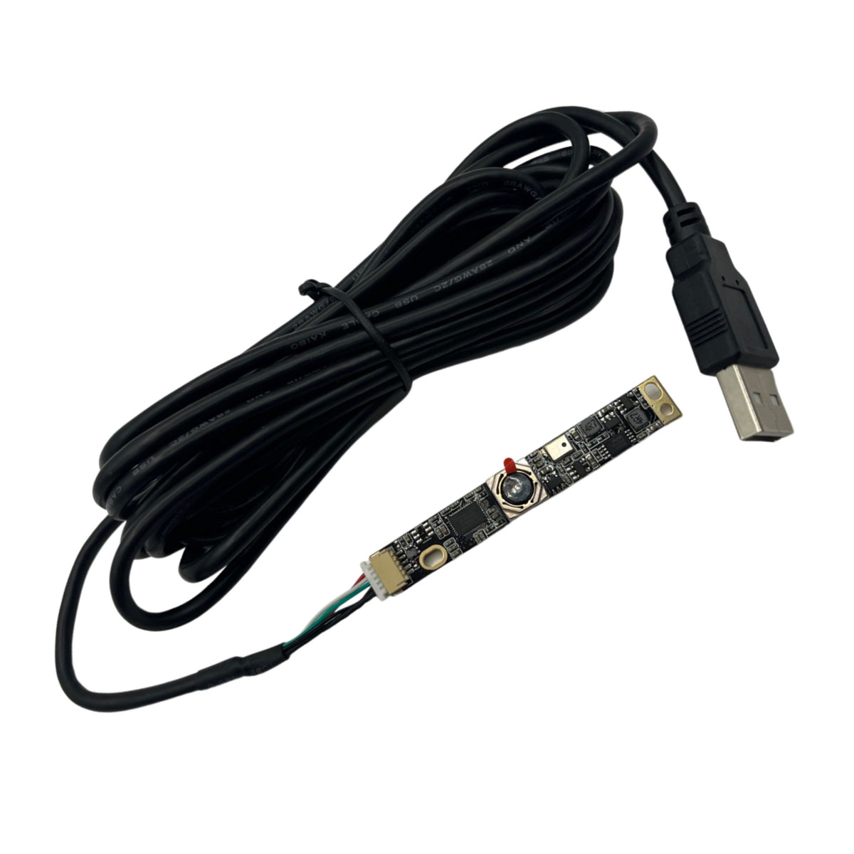

This is a 5 megapixel (2592 x 1944) USB camera, configured by the manufacturer for use with LightBurn, and will work equally well on Windows or Mac systems. The camera uses a CMOS sensor, with automatic exposure and white balance, and a manually focused lens.
Each camera comes with a lens of your choosing, and a 3.2 meter (10 foot) USB cable.
If you are outside of the US, you may be required to pay import duty on this item, as well as any additional fees assessed by the package carrier.
These cameras are exactly as shown, with no enclosure. You will need to produce an enclosure or mount. These fit our small camera mount, which you can purchase from us here. Also note that camera sales are final - we do not accept returns, though we will replace units that are damaged or defective.
