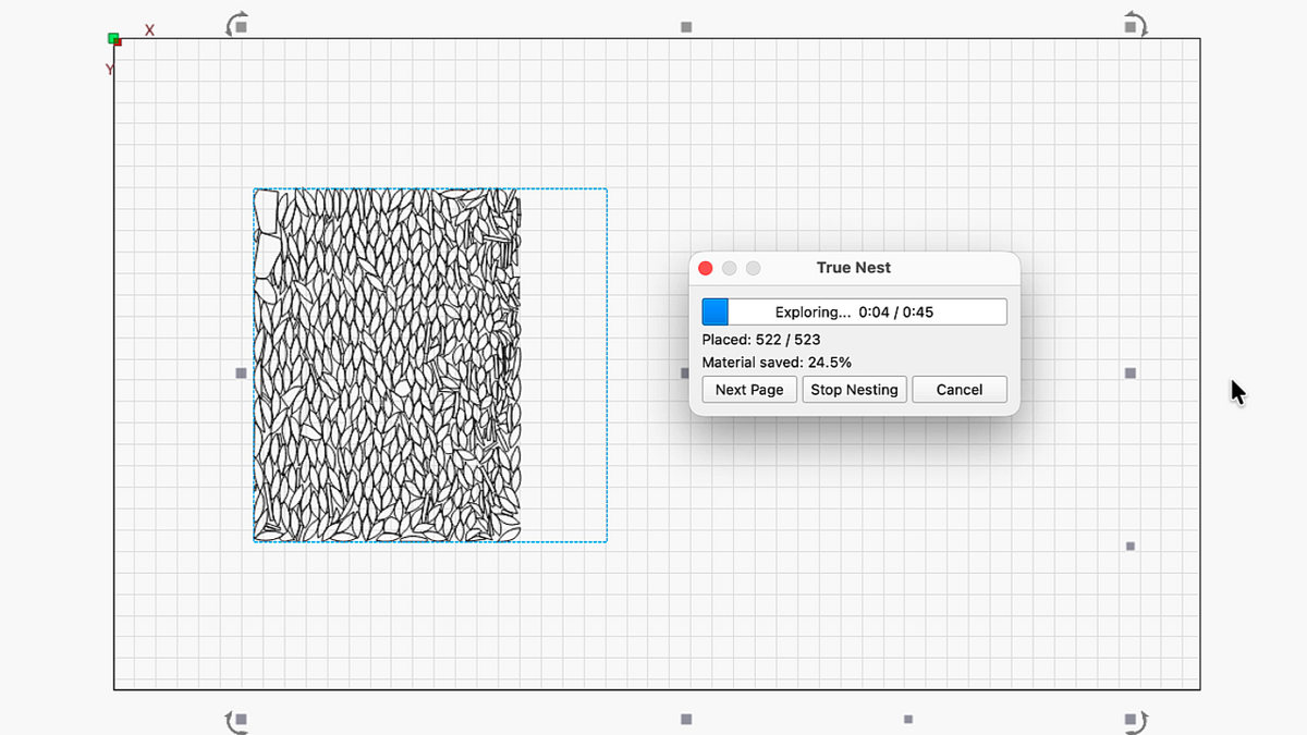

True Nest (Pro-Only)
It's here — a full nesting solution, built into LightBurn. In 2.1 we added Quick Nest, a blazing-fast option that nests objects based on their bounding boxes.
Now we've upped our game with True Nest, which nests objects based on their actual contours. You can choose from four Optimization levels that determine how long it spends generating the best layout, but all of them are shockingly fast — especially compared to doing it by hand.
An important note: True Nest is the first LightBurn design/layout feature that is limited to Pro licenses only. We made that choice because premium features like True Nest are really hard to write, and the only way we can develop features like this and still keep the lights on is to charge a bit more. We also recognize that not all users need it, so rather than raise prices across the board, we chose to make it Pro-only as the fairest option.
If you're a Core user, upgrade to Pro if you think True Nest will help you work faster and save money on material. It shouldn't take more than a few sheets-worth of savings to pay for itself.
Learn More
