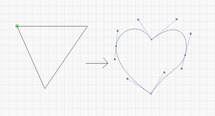

New node editing tools:
- I to Insert a new node point along a line or spline
- C to convert a smooth point to a sharp Corner
- L to convert a smooth curve to a straight Line
- S when over a line to convert a line to a Smooth curve
- D to Delete a line (and break the shape) or delete a point (and keep the shape intact)
- S when over a point to make it a Smooth point
