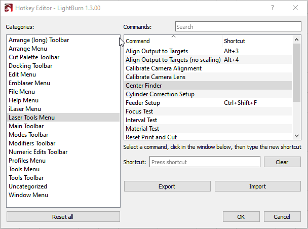

Hotkey Editor
Many have requested this, and as LightBurn has gotten more popular and added more features, it's become harder to find free hotkeys that will work on all the keyboard layouts around the world. With the addition of the new hotkey editor, you can customize most of the shortcuts in LightBurn to your liking. Any button on the toolbar can be given a hotkey, and it includes a search function to help you quickly find them. You can find it near the bottom of the File menu.
