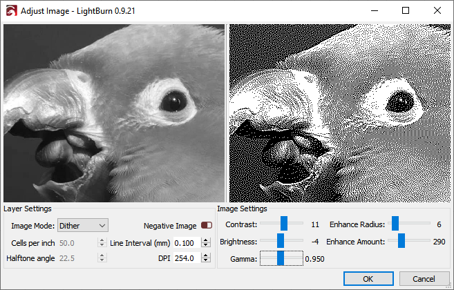

Adjust Image tool
LightBurn has had the ability to adjust gamma, contrast, brightness, edge enhancement, and more for quite a while, but it seems most people don't realize these options exist, so we've made a new tool specifically for adjusting image controls.  Right click and choose 'Adjust Image', or access it with Alt+I or from the Tools menu.
All the controls are live, and the dual-pane window shows the original and adjusted image side by side, making it easier to see the results.
